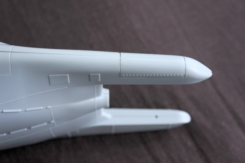

    There is an access hatch already marked out on the stern, I see...that would be ideal. Just right for a very careful cut with a fine razor saw blade.

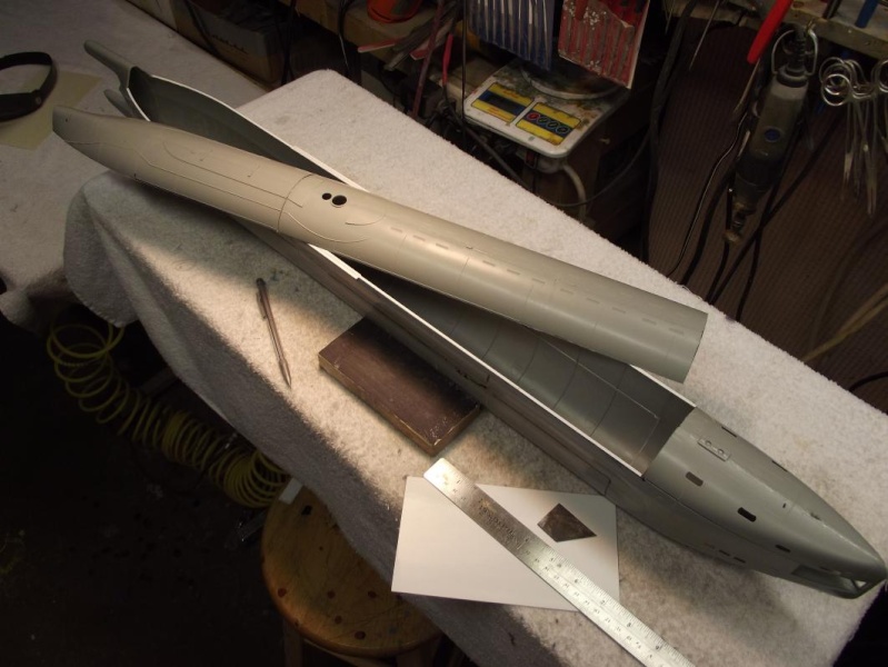

    This is the above mentioned, and the most dreaded ''long cut''...one false move here, and the whole thing is ruined.

    Richard, mine was a mess when I did my cut. You can always fix it.
    Bronco Type XX111 - Page 2 Empty Re: Bronco Type XX111
    Post  Tom(ADMIN) Mon Dec 30, 2013 6:28 pm
    A few strips of styrene strip and a spot of Andy's magic filler will cover anything, Tom...

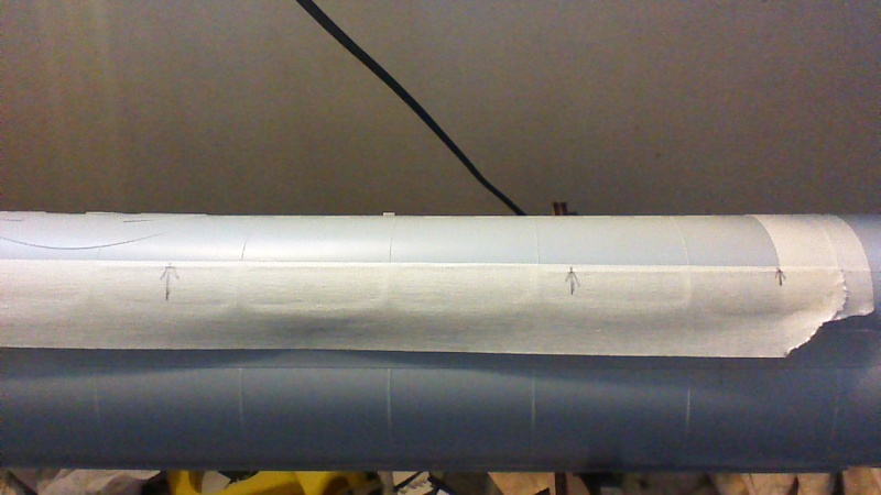

    Here we go then...hull all marked out, new razor saw bladed fitted...wish me luck, I'm  going in.

    so come on then how did it go
    Post  Tom(ADMIN) Wed Jan 01, 2014 3:40 pm
    Not good, couldn't get the cut lines level. I'll remark it out later after a beer.
    (perhaps that's why I couldn't them straight last night?)
