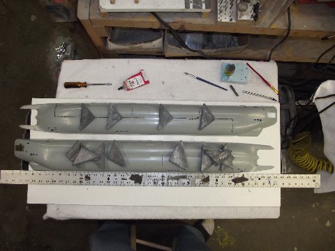

    I've just been discussing with David as to how to glue up the four hull sections, his recommendation is to glue the bow and stern section of one side, then the same with the other two pieces, then glue the two halves together. See David's photos below:
    Type XX111 U Boat by Bronco Models Dscf3910
    Type XX111 U Boat by Bronco Models Dscf3911
    Type XX111 U Boat by Bronco Models Dscf3912
    Type XX111 U Boat by Bronco Models Dscf4010
    Type XX111 U Boat by Bronco Models Dscf4011

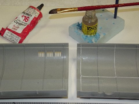

    Post  Tom(ADMIN) Wed Dec 11, 2013 3:10 pm
    And here's the hull sections of mine, I've removed the internal half bulkheads, just needs a bit of sanding down to finish the job off, then I can glue the sections together as per David's instructions.
    Type XX111 U Boat by Bronco Models Dsc00725
