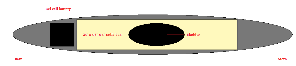

There will now be a slight delay to the build log...I'm in the process of ripping everything out of the boat, replacing the WTC with a bigger and rooomier custom built r/c box (made by Mark @ MMB) and totally altering the ballast system.
Instead of using a remote ballast tank, I'm going to replace it with an internal bladder, same idea as the Thunder Tiger Neptune uses.
Something like this...
(Diagram NOT to scale...)

Whilst awaiting the new radio box to arrive I made up the new ballast tank...
This consists of a 2000ml saline bag inside a 9" long section of 90mm acrylic tube, top filled and vented to air by two 1/16th" holes, all built to Nigel's design. (thanks Nigel!)
The bag itself has had the one way valve removed, and is rolled inside the cylinder...the cylinder has a central threaded rod running through it to secure the end caps, this is covered with a length of plastic tube so as not to stand any chance of puncturing the bag.

[hello new to subs , have la hull coming and gathering bits at moment.
now am confused ,i assume richards hull will fill with water through holes in the hull then it floats at normal waterline .following water pumped into the ballast tank in the wtc it goes to decks awash and then is driven under by foreward movement under plane control ? am i right?
so its a dynamic sub system not a static.
sorry the lack of understanding but gradually getting hang of this new game.
rgds geoff ]
rgds geoff ]

It is a tricky point of definition, I suppose, but I'm not sure how important definitions are anyway.
I would say that if the sub does not have any form of ballast tanks then it is a dynamic diver. Hence Richard's sub is a static diver? Sound like a job for "Sea Lawyers!"
I take it you have looked on the descriptions on the main AMS website?
