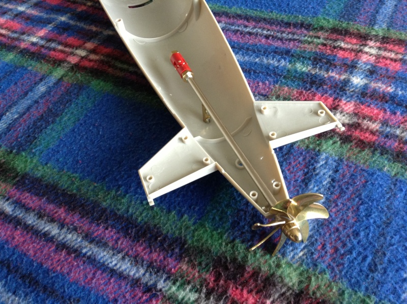

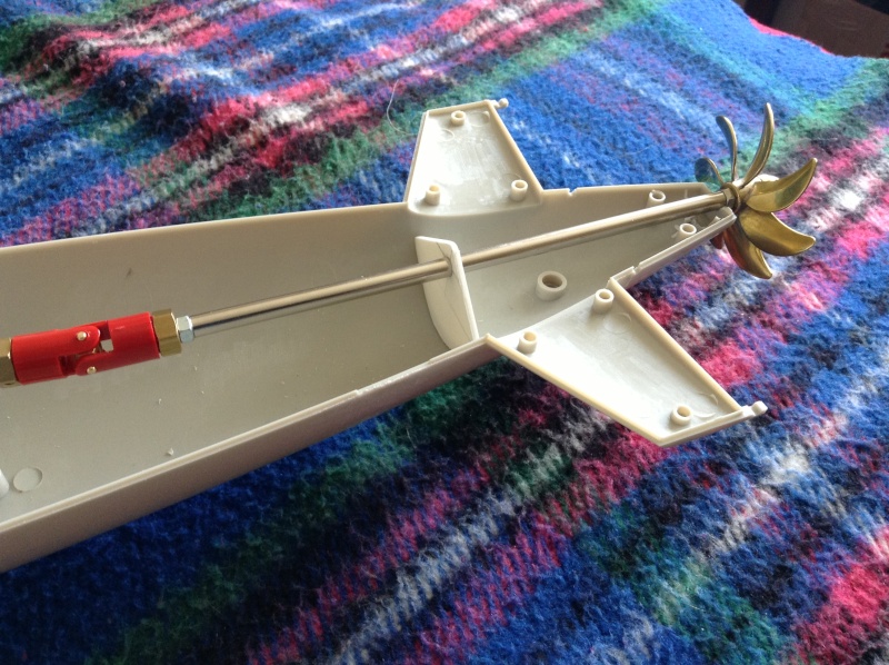

    Post  Tom(ADMIN) Wed Aug 14, 2013 10:42 am
    Dry run of the prop tube support.

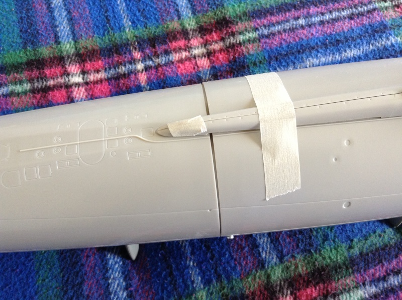

    Post  Tom(ADMIN) Mon Aug 19, 2013 10:16 am
    This wasn't in the script! When both of the top deck sections are placed together, a large gap has appeared. We are not amused...

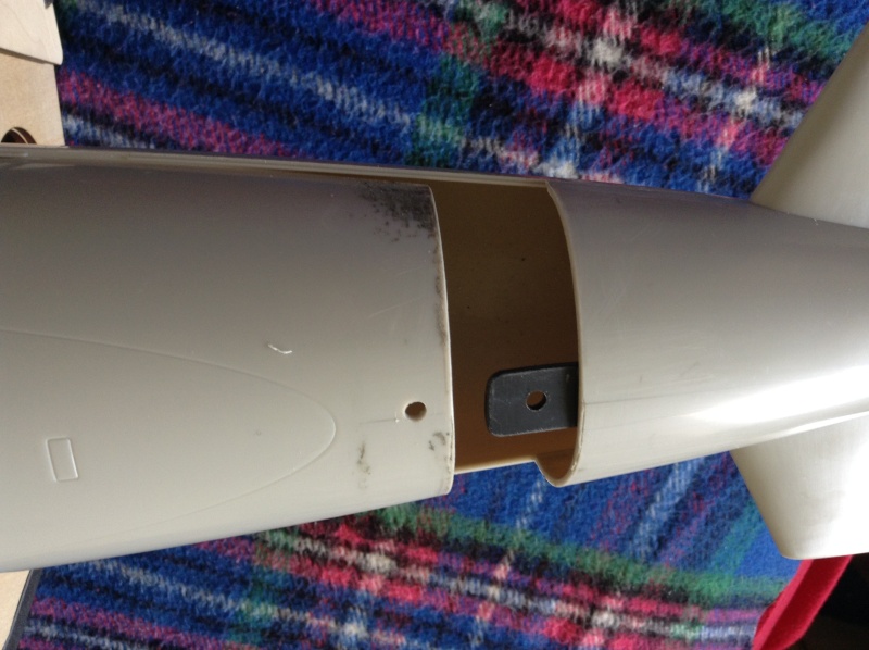

    Today it was a case of taking my life in my hands and cutting the rear cone from the top deck unit.
    After reading David Merriman's cabal reports on the Skipjack, and measuring carefully...measuring again...and measuring the measurements, I took a razor saw to the deck and cut the cone off. I'm pleased to say that it was a nice square cut, and after minimal sanding, everything fits nicely with the minimum of a gap.

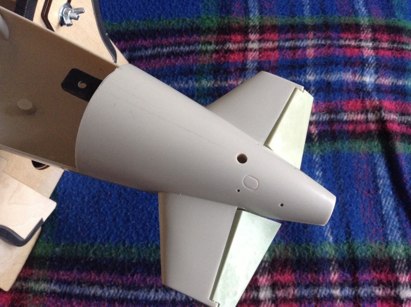

    Post  Tom(ADMIN) Sun Aug 25, 2013 2:54 pm
    Another little job done today...drilled the rear cone and the rear deck for the hold down bolt. The simulated "sonar dome" which covers the nut is a temporary job, I need to make a bigger one.
    Ignore the gap, when everything is fitted properly it's much tighter than the picture shows.

    Oh, and in case you were wondering what the black 'stuff' is on the rear deck section, it's residue from the tape I used to mark the cut line... I couldn't find my masking tape at the time.

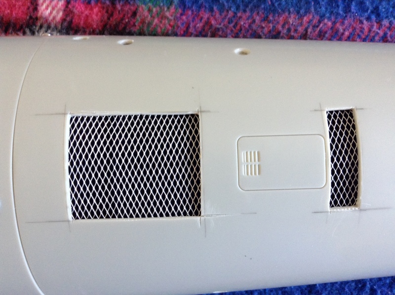

    Post  Tom(ADMIN) Tue Aug 27, 2013 3:53 pm
    Another little job done today...the flood holes are now covered inside with alloy mesh to keep foreign matter from getting near the water pump. The mesh is secured inside the hull with superglue and masking tape...once dry, I'll cover it with epoxy glue, exactly the same as I did with the Dragonfish.
    I can hear the purists screaming "but it's not scale"...maybe not, but cutting the holes out to a larger size was so much easier on my hands and fingers.
    (a little of Andy's magic filler and a spot of sanding is called for by the looks of things..)
