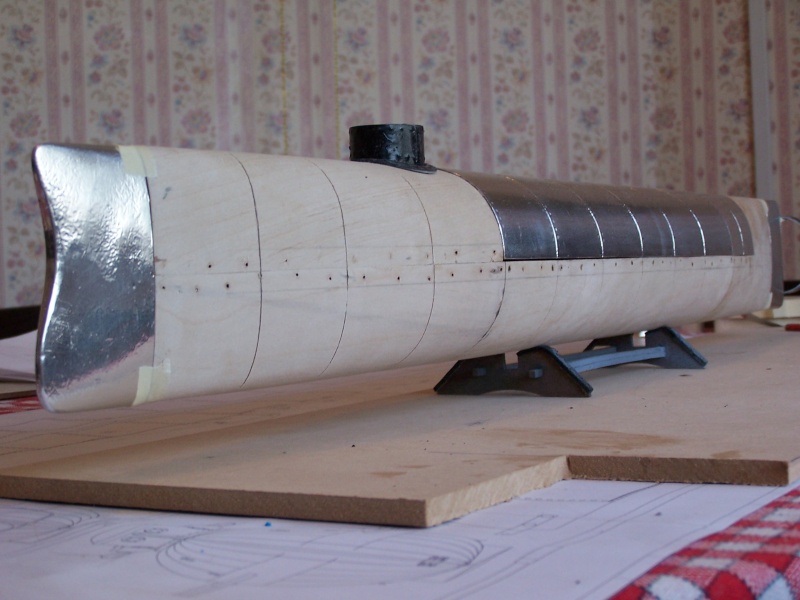

main hull with rivet holes drilled,the Hunley has flush counter sunk rivets so no rivets will be used on the hull,ally tape will be applied to the hull and lightly pushed into the holes which should give the appearance of dimple's

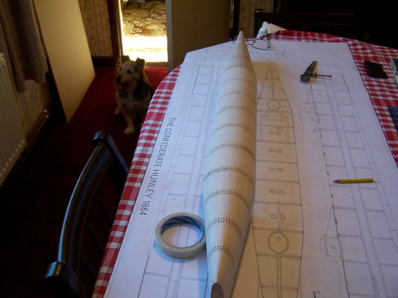

quality control officer bob inspecting fully drilled main hull awaiting ally tape.

anoter view of the main hull.

and another.

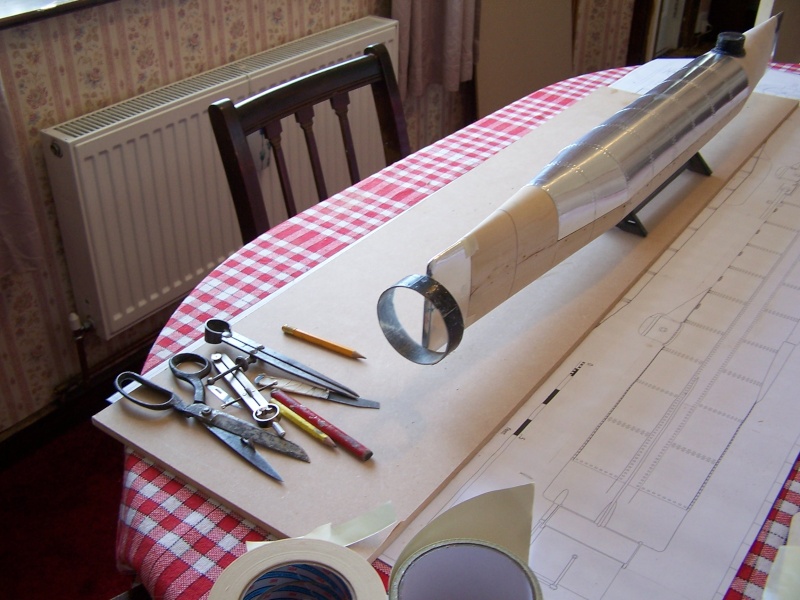

starting to apply the ally tape to the bow section.
