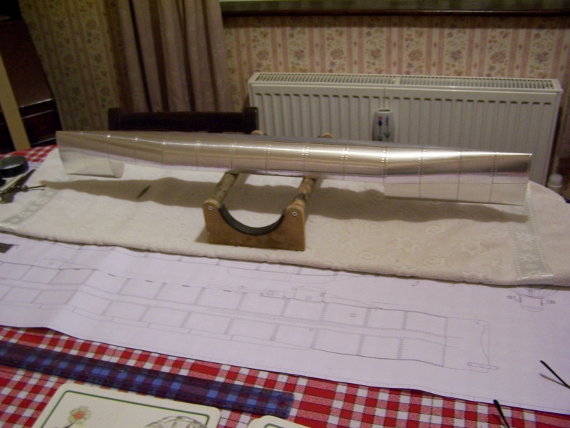

      CSS HUNLEY - Page 2 Empty Re: CSS HUNLEY
      Post  nigele(ADMIN)2 on Wed 19 Sep 2012 - 21:29
      CSS HUNLEY - Page 2 100_1724
      Bow and stern with ally tape applied.

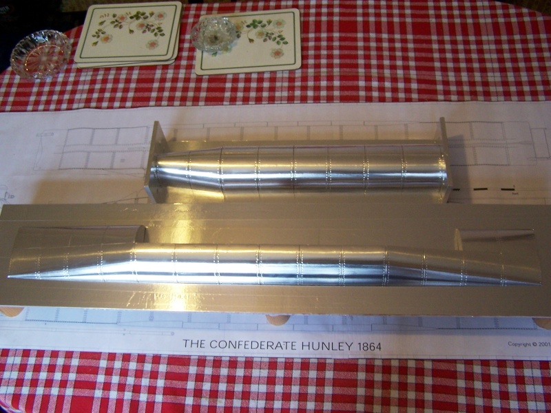

      Post  nigele(ADMIN)2 on Wed 19 Sep 2012 - 21:34
      CSS HUNLEY - Page 2 100_1725
      A few views of the hull with the tape fully applied.

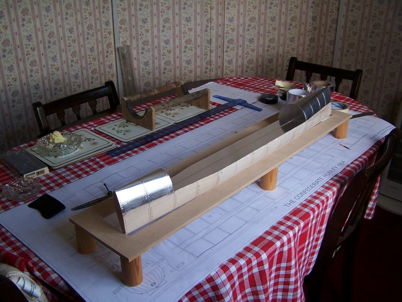

      Post  nigele(ADMIN)2 on Wed 19 Sep 2012 - 21:51
      CSS HUNLEY - Page 2 100_1730
      Mould for rear section,the original boat had a cast bow and stern,so in an atempt to copy this the pattern was covered in ally tape and 80 grit paper was pushed onto it to give the effect of a sand casting,hopefully.

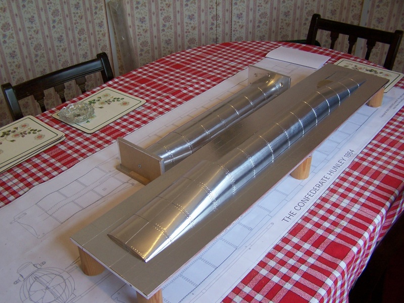

      Post  nigele(ADMIN)2 on Thu 20 Sep 2012 - 16:38
      CSS HUNLEY - Page 2 100_1733
      Hull and hatch cover ready for moulding.

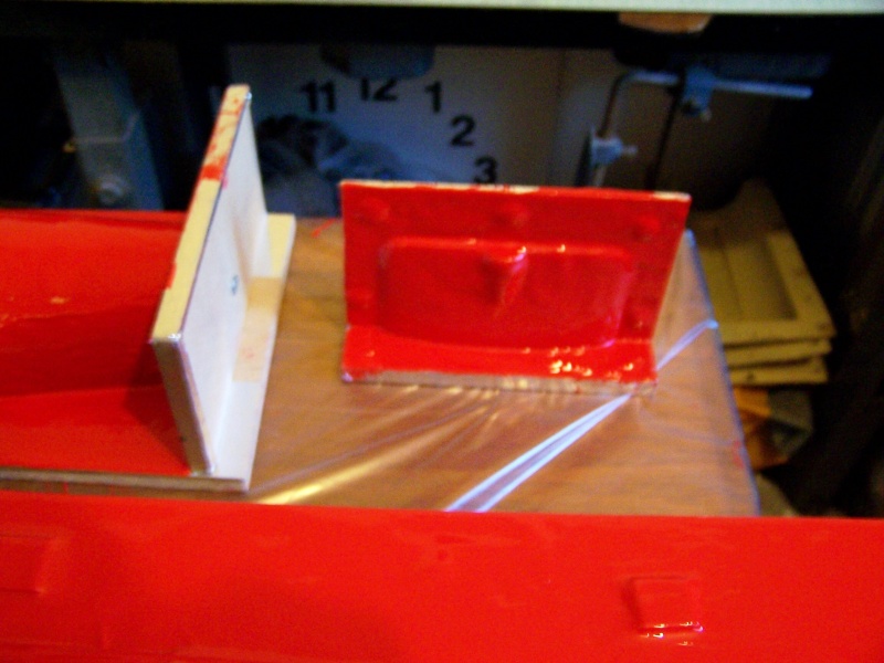

      Post  nigele(ADMIN)2 on Wed 26 Sep 2012 - 18:05
      CSS HUNLEY - Page 2 100_1810
      Ready for gel coat.
