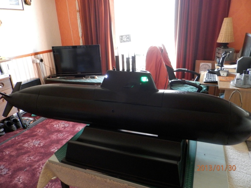

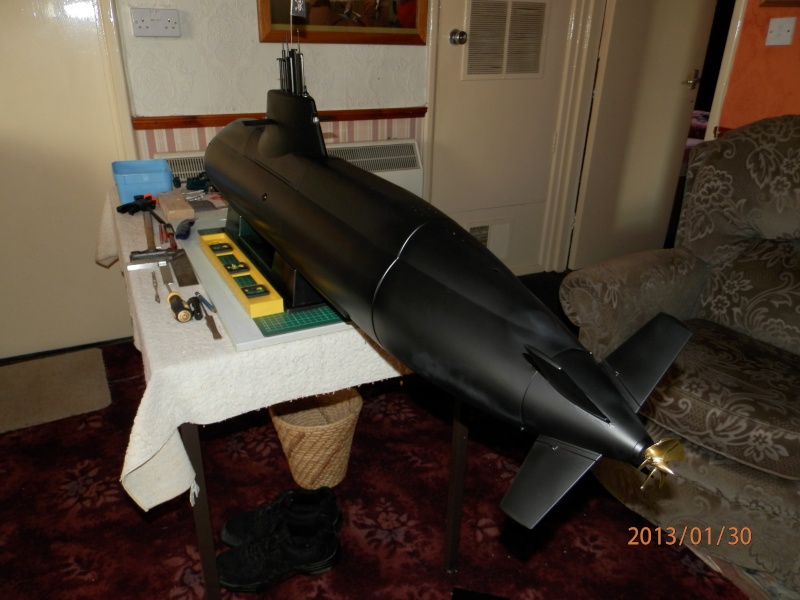

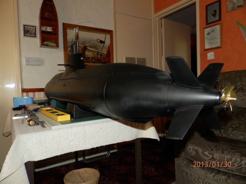

    Post  wadsworthj on Wed Jan 30, 2013 8:14 pm
    Gere hopefully, are the latest build piccys, lots more to do yet.
    and unfortunately, my bath is not big enough to test it.
    Hey Ho!!
    Cheers John . W
