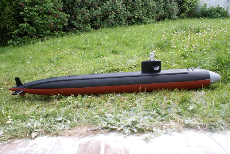

    Just finished off my LA class, thought you'd all like to see it
    Got a couple of bit left, just the linkages and fixing the shaft in, then it'll be ready to go...

    Coming along nicely, Andy...what ballast system did you decide on?

    Hasn't got one mate, just dynamic. Was gonna be the Sheerline system but was going to end up so tight I didn't bother.
    It's just got a piece of 65mm waste pipe, I turned up the end caps from laminating resin, and it's powered by a 555 with a 60mm 7 blader.

    That is one big brute to have as a dynamic dive boat, mate...you'll be needing an awful lot of lead.

    Looks very nice.
    I'm sure it will be fine as a dynamic diver.
    Ballasted to have decks nearly awash. Plenty of grunt from the motor and that battery.
