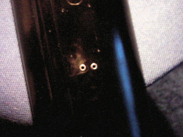

    Here's a little trick I used to tidy up ragged edges or little chips when drilling flood holes..
    I popped over to the recycling centre earlier, and dragged out an old pair of trainers someone had dumped..took the laces out and then cut out the little brass eyelets where the laces go through.
    Drilled out the flood holes, then pushed the eyelets in through the hole, and secured them with a drop of superglue from the inside. It gives a nice neat finish to the hole, and when painted they hardly show.
    Recycling at it's best..!

    Very shiney Rich.....
    Either that or stick the drill in reverse first, it files a smooth hole instead of cutting in...

    My arm doesn't go backwards...

    Ah, then another handy hint...
    Get a cheapo cordless drill, pays for itself after one model. You can get them with lithium batteries in, which I've got, and they last forever...
