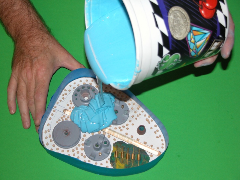

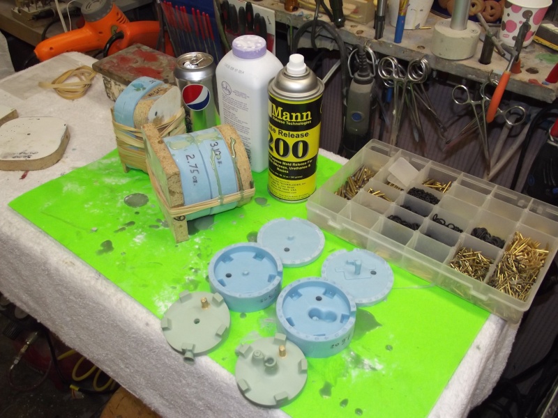

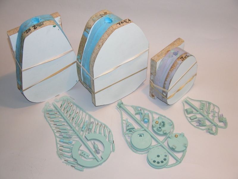

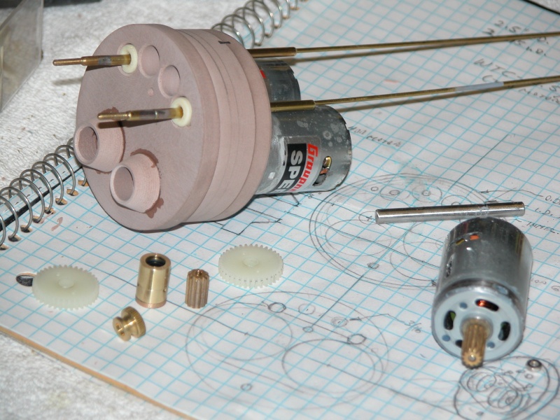

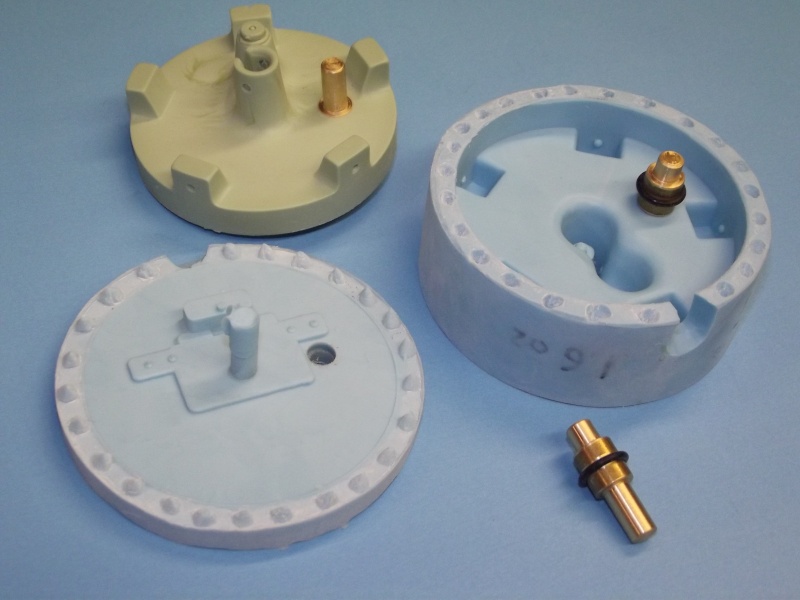

    Post  merriman on Tue Jul 28, 2015 1:20 am
    WTC  End Caps Dscf7610
    WTC  End Caps Dscf7611
    WTC  End Caps 02110
    WTC  End Caps Dscn0133
    WTC  End Caps Dscn0134
    WTC  End Caps Dscn0135
    WTC  End Caps Dscn0136
    WTC  End Caps Dscf3810
    WTC  End Caps Dscn0132
    WTC  End Caps Dscf3811
    WTC  End Caps Dscf3812
    WTC  End Caps Dscn0045
    WTC  End Caps Dscn0131
    WTC  End Caps Dscf3813
    I share these technique so you can make multiple parts of YOUR work or the work of others whose permission you have secured.
    Don't steal.
