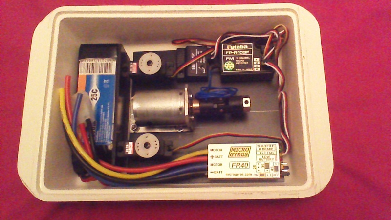

    Post  Tom(ADMIN) on Sun Dec 01, 2013 11:25 am
    And the problem solved...new top and new clear lid made up for the radio box, just need to decide whether to use O ring cord or rubber sheet for the watertight seal, then I can cut the bolts down to size.

    Post  salmon on Sun Dec 01, 2013 4:15 pm
    Very sharp looking! That wtc is coming along nicely Richard.
