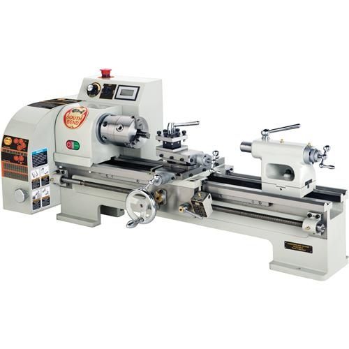

    I have been looking the an 8"x36" South Bend Junior.
    The new South Bend 8"x36" #1001 lathe has been getting rave reviews on www.practicalmachinist.com/forum
    The price has been slashed, too.
    looking for a lathe Image-1414
    http://www.grizzly.com/products/8K-8-x-18-Lathe/SB1001
